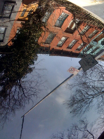

My Cruiser had swirls on the hood and trunk so this weekend since the weather was finally nice I gave it a good cleaning
1. I gave my Cruiser a good washing
2. I clayed the hood and trunk
2. I used Mequairs cleaner polishing wax
3. Then I used my favorite car wax its made from a company called IBiz
4. Last I used Meguairs Ultimate Quik Detailer
I did this all by hand, came out pretty good too cant see the swirls, they were really bad before. Below is an photo I took of my hood, the shine is awesome

wow it took me awhile to figure out that pic but got it now great looking job

Hey their digitalpinscruiser,
Looking really good, and that is a great example of how you can remove swirls by hand!
