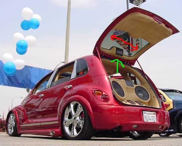

Just got a couple decals from these guys. One in the high mount brakelight decal... needing to know how to remove the high mount brake light to put this on...

open your hatch, remove the plastic shroud that surronds the breaklight ( it's on by clips ) then you will see two screws u can use phillips scredriver or an 8mm socket to remove and voila all done
to replace it is the reverse

i totally agree but here's a picture to help. the red arrows show the pillars you need to take off and the green arrow shows what you need to take off to get the the 3rd brake light. take off the pillars and then the 3rd bl cover.
