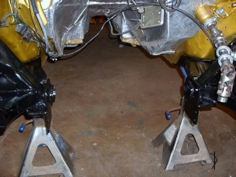

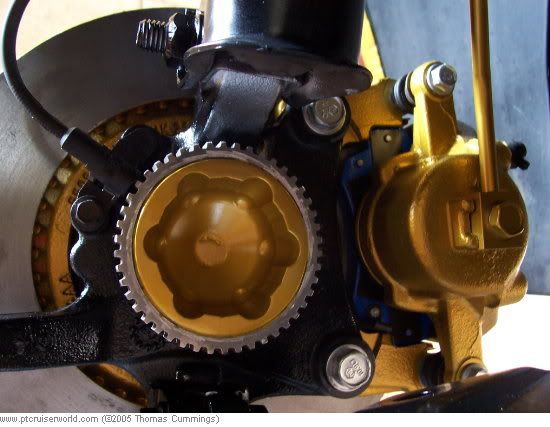

Hi Rusty, before I had cut the cross member, I made some referrence marks on the under side of the driver and passenger side frames and took the measurement across from frame to frame, and to the ground. After the cut was made, I checked to see if these measurements had changed, they did not. All the measurements remained the same. I think it had something to do with the placement of the jack stands on the main suspension frame, shown in the 2nd picture below, which did not allow any movement after the cross member was cut. I also completed the welding of the main cross member driver and passenger side support brackets shown below in the 3rd and 4th pictures below. The holes on the two stubs of the main cross members will be trimmed and covered with plates and welded solid as well. As for where the half shafts attach to the brake rotors. If you look good at the picture below you will note that I have removed the outer cv joint (gold in color with gear teeth around it) from the half shaft, I then grinded off a portion of that outer cv joint, painted it and re-installed it. This is what keeps the rotor and bearing assembly in place. Your project idea sounds very interesting. After I started on my project, I did look at the Prowler drivetrain assembly and was very interested in using it. But I had already purchased most of the drivetrain components that I needed for my project. Other wise, I would have gone with the Prowler drivetrain. As for the electrical side of your project, my experience has shown me that it is best to use the same engine harness and computer from what ever donar car you chose. This will make things much easier for you, believe me! Thanks for sharing your project with us. Be sure to post pictures of your progress. I will be posting more pictures shortly. Thank you, Tommy.

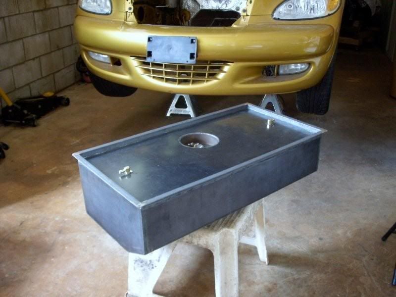

Here's the new modified gas tank that I picked up yesterday from the shop. It is equipped with two roll-over vent valves on the top left, and right sides, and the sending unit and fuel pick-up tube is located inside of the middle recessed hole. The angle iron frame around the tank will sit flush with the trunk floor. Then the cover plate will be installed on the tank which will act as the new floor section that was removed, shown in the second picture below. The gas tank, angle iron and cover plate, is made of mild steel. The cover plate is 1/8" thick. The gas filler tube is welded in and is located on the other side of the tank. The mounting holes for the tank and cover have not been drilled yet. After I drill the holes, I will then be sanding, priming, and painting the tank and cover. Thanks for looking, Tommy.
It doesn't appear painted - aren't you worried about rust? I'd powder-coat it.
  #47 (permalink)
Old 13 Nov 2009, 02:49 pm
Join Date: Oct 2009
Location: Waianae, Hawaii
Posts: 174
Default Re: PT Cruiser V-6 Conversion!
Yes, I will be correcting a problem I observed on the long side, of one of the angle iron pieces. It is not completely level. It has about a 1/8" downward bow in the center. Hard to tell by looking at the picture. It is the right side as you are looking at the picture. I need to correct this problem other wise it will place a warp in the floor. It must be as level as I can get it. Should be an easy fix. After I correct that, I will sand these items, prime them, then paint them. I generally use a high heat engine paint for items that are exposed to the elements. The bottom of the tank will be black in color, and the top section and cover plate will be gray in color. I would love to have these items powder coated, however, that option does not fit into my current budget. Thank you for your support and concern. Aloha, Tommy.

It can rust from the inside, too... "rust never sleeps"...
Beautiful work.
Beautiful work.
Yes, I'm aware of this! I hope it does not become a problem for me. I have had many cars, and they all had steel gas tanks. I have not experienced any problems with rust build up inside any of the gas tanks, for any of the cars I have owned. I have read articles about people who did have problems. I can only hope I don't become one of them. I will have one fuel filter installed right outside of the gas tank, and another just before the carburetor. I hope it helps! Thanks again for your concerns and commemts. Aloha, Tommy.
