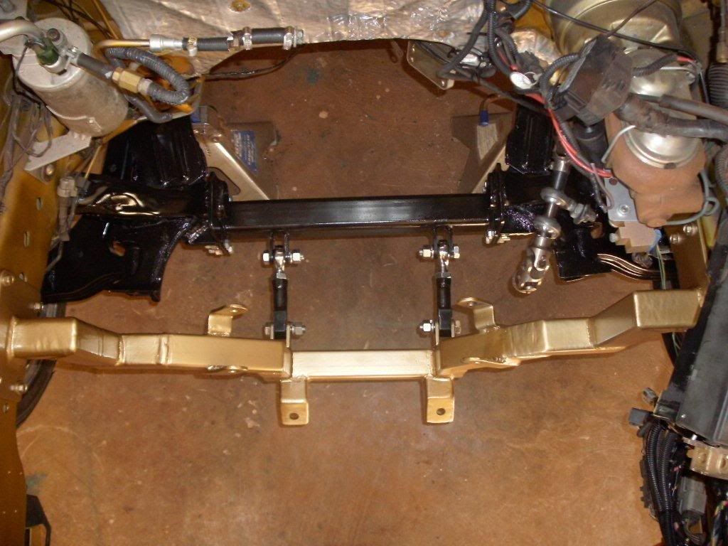

Here is a progress update! This picture shows the forward engine mount and rack & pinion cross member, and the main rear cross member installed and how I tied both of them together for added strength. I have also been working on my sons 2003 GT Mustang. That is the reason why progress on the PT has been slow. It should pick up now. Thank you, Tommy.
