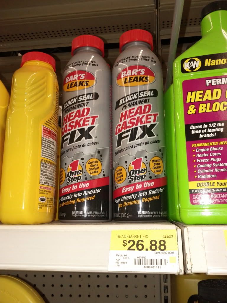

One thing you might want to try as a temporary fix,if you do have a blown head gasket,just until you get a chance to fix it is this:
Photo courtesy of: BustedPT
I wouldn't recommend some of the 'cheapy',or 'off' brands,as they can end up sealing things you really DON'T want getting sealed.
I'm pretty sure we've seen owners come to the forum after buying their "New-To-Me" cruiser that didn't know the previous owner had thrown a bottle or two of that stuff in before trading in their car.
Actually this and the others similar to it. Do a good job without causing any side affects. That said I still see these as a temporary fix that I would get fixed. just me.
