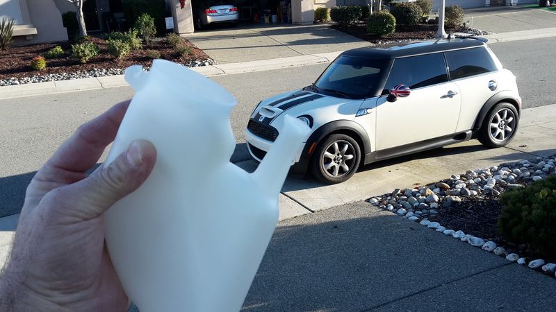

I am so happy that this is the coolant reservoir for the MINI. Easy to clean.
Oh wait...here is a better picture of it.
No way!!!! The engineer that designed that thing must have some emotional problem... like.. was dropped by his first and only girlfriend...

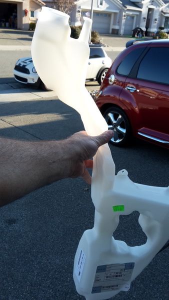

Dude..... I got a new one so I could plumb it for my water injection system and have it ready to install. When it came in I thought it was a mis boxed or labeled part and had to go to the FSM and look up a picture. It will take me about 4 hours to replace it when I do the change.The bumper fender inner fender well and part of the intake system has to be removed WTF!!!
Oh well the price we pay to mod something right?
Btw it is the wiper not coolant reservoir I just wanted to post the painful picture of the project.
However the coolant reservoir on the MINI is a 3 chamber. A PIA to clean. But next time I am going to try the rice.
