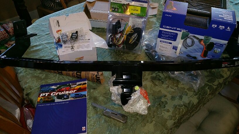

Santa brought me this and it was in the budget
don't know about L.A. wash/oregon you could get a Used trailer around $500-$1200 then sell it later
Rent one would be the way to go if you going one way
