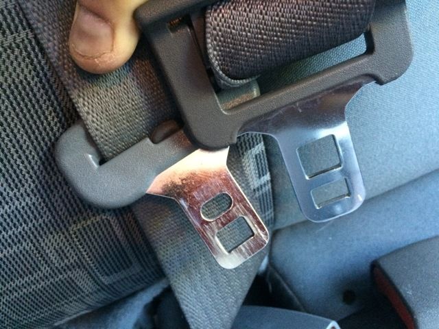

I ruined the left rear seat belt in my 2009 PT Cruiser while installing the subwoofer and thought that all models used the same seat belt so I went to the junkyard and got a first generation PT left rear seatbelt. That seatbelt behaved just like yours. It does lock but you have to pull it really hard to make it lock (similar to the force experienced in a collision). In a real collision, it would work.
The buckle was of a different size and would not latch in the receptacle so a few weeks later I found a 2nd generation PT in another junkyard to replace it with.
1st Gen seat belt vs 2nd Gen.
