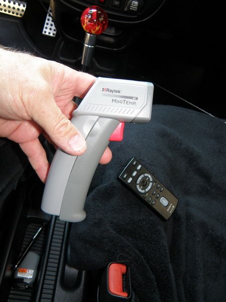

Whenever you use the diagnostic connector for scan tools or DATA viewing devices like my recommended ULTRA GAUGE they are using the on board sensors for their input information. The assumption is that those sensors are in working order and sending correct information.
In the case of operating temperatures a follow up should be a hand held temperature gun.

I have a couple questions. i have an IR temp gun similar to that (everyone should have one. they're dirt cheap and wonderful for finding where you're losing heat/cold in a house. Even good ones are less than $80. Mine is a Fluke 62 MAX IR and I think it was $80?). Where are you pointing that to verify the ECT result? I honestly don't even know where the ECT is getting the info. are they screwed into the block?
Second, if i'm testing this driving down the road, i can't use that tool. are you referring to testing in the driveway? because it varies quite a bit from sitting idling and driving.
I don't know where i'd point the gun? the outside of the radiator? does that give effective readings? i assume the dissipation of the heat would change that. is it that it doesn't change it enough to matter? Honestly never thought of trying that

I have a couple questions. i have an IR temp gun similar to that (everyone should have one. they're dirt cheap and wonderful for finding where you're losing heat/cold in a house. Also they are fun to use in the bedroom Even good ones are less than $80. Mine is a Fluke 62 MAX IR and I think it was $80?). Where are you pointing that to verify the ECT result? I honestly don't even know where the ECT is getting the info.
I did not suggest to use it for this testing driving down the road. If you re-read I said to verify the *coolant temperature sensors information.
For diagnostics you take multiple reading in several areas to gain information about how temperatures are being radiated.
I would suggest look at the pictures posted on the provided thread in my previous response?
*The coolant temperature sensor is located in the thermostat housing

Since you are reading the temperature using the temperature sensor, the ideal spot to check is at the temperature sensor location:
Coolant Temp Sensor Location
Now sometimes those IR meters don't like the surface it's looking at such as shiny surfaces (like the top of a pool of molten lead), but around the neck of the coolant filter is a fairly good location.
