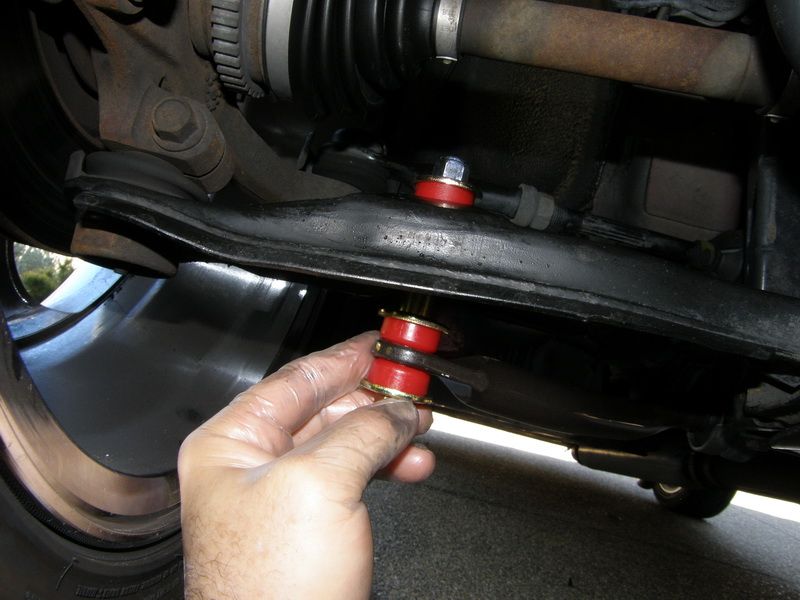

Hey folks. I have that annoying clunk in the front end. Replaced the lower motor mount and control arm. However, the friend that was helping me (and did most of the work) reinstalled the sway bar end links. I'm pretty sure those are whats making the clunk. They don't seem to be mushroomed and I'm seeing a little bit of space. I can't replace them this week. How do I tighten them? I try tightening by the bottom nut, but the bolt spins. I don't see anything to grab to keep it from spinning.

For the end links that are on now. How exactly do I tighten them? I don't see another nut for me to clamp onto. When I just try to tighten the bottom the whole thing spins in place. I'm sure I sound pretty stupid, lol.

Mine isn't like that. I still have the factory setup with no nut on top. Maybe just find a nut to put on the top? http://www.ptcruiserlinks.com/forum/...1&d=1491257120

Some vice grips on the fixed washer end worked when I removed my originals.
Should serve to tighten as well!

Yep, when I replaced the OEM ones on mine, I had to do what JDK52 suggested. Vise grips work just fine. You WON'T be able to silence the old ones, so don't waste your time trying. They're most likely shot.
