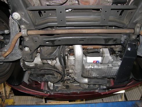

For reference....
wow! look how dirty our PT was under there in 2013.
