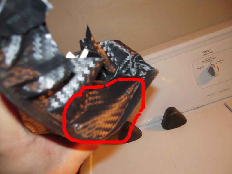

8. Now it's time to burn the edges. little by little heat small areas of the edges and press down as hard as you can. Be careful, it'll be really hot. If your heat gun has two settings, use the hottest one when burning the edges. only heat the area for about 5 seconds then press down. if you heat the area to long you'll notice the vinyl start to bubble, and sometimes, it'll even rip.
see how flat the vinyl is before it overlap the fins on the pillar.
if you encounter some thing like this, you can either burn the vinyl or just cut it inside the corners of fins like this
