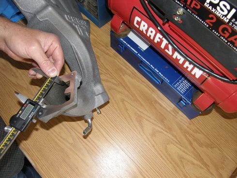

This is not a stock TB (Throttle Body)
The measurement is at the top not the inside runner area which tappers down small to around 51-52mm which is even smaller then the OEM TB bore size?? ??? Yup?
Look at the gasket compared to the port. Lots of material can be removed and blended into the port. The trick is to match the intake port size and shape to the head.
