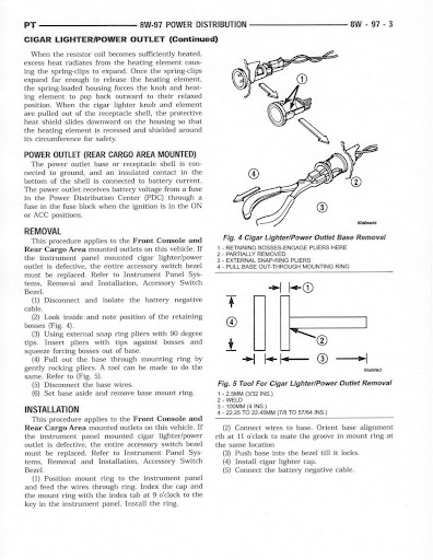

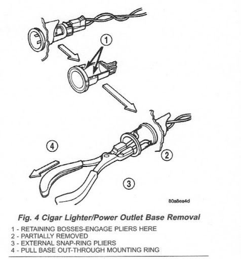

found this page in the service manual. It shows use of special tools, but I'm sure you'll find a way to improvise.

Thanks for the help, ADR!!! I'm quite sure I can figure some way to pop that sucker out. Didn't want to have to disassemble the whole console for this little thing.
