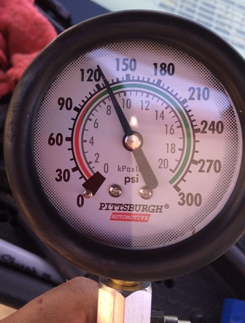

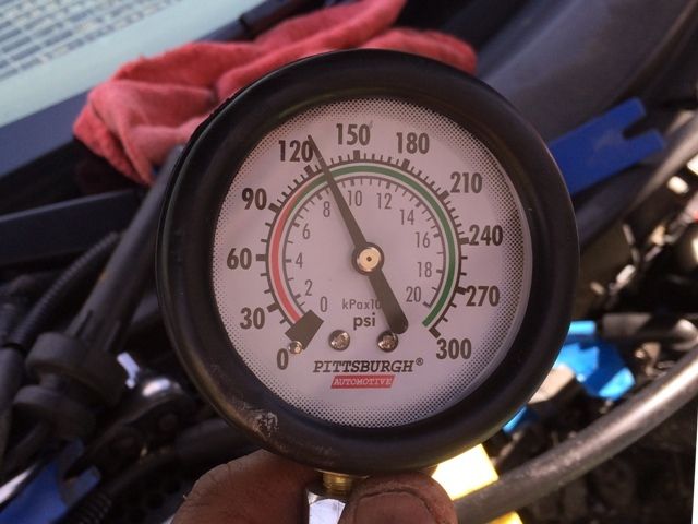

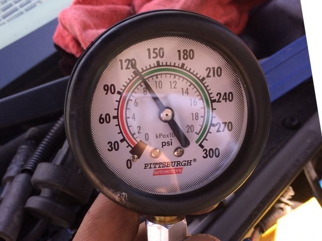

I've never performed a compression test, but it isn't very difficult at all. Just attach the correct adapter to the hose, screw the adapter into the cylinder, attach the gauge and crank the engine. Make sure all spark plugs are removed and no power is getting to the distributor. NitroPT recommended 5 revolutions to get to max pressure. This was very easy to hear while cranking the engine.
Cylinder 1
Cylinder 2
Cylinder 3
Cylinder 4
Wheter it's totally accurate or not isn't as important as they are all over 100 psi and within 25% of each other as specified by the manual.
