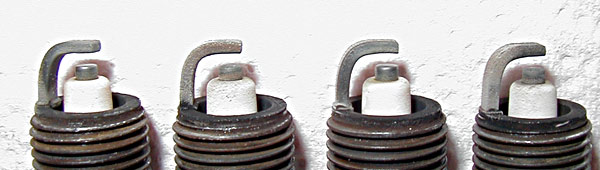

Here are the OEM spark plugs I just removed:

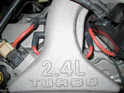

Here are the Magnecor's installed, note all four have 90 deg right-angle boots at the coil (whereas the original MoPar's had three straight boots at the coil and one 90 deg (the one that went to the cylinder furthest on the right)):
You can see that you can angle the wires "upward" at the coil to get them further away from the valve cover (and, thus, further from heat) than you could with the original MoPar straight boots.

Judging by your pictures of the plug it looks as if two are good and two are not!
Another reason for stumble?

I wondered if the two plugs on which the electrode was more worn could have caused the stumble, but I encountered it again today, so it must not have been the plugs or wires! The stumble I'm referring to occurs when I'm crusing in 3rd or 4th (I have autostick) and I decide to accelerate around someone, but not a hard acceleration. When I gradually, but firmly, step on the gas, my GT hesitates and sometimes seems to stumble/misfire. I'm hoping Stage 2 takes care of that!
