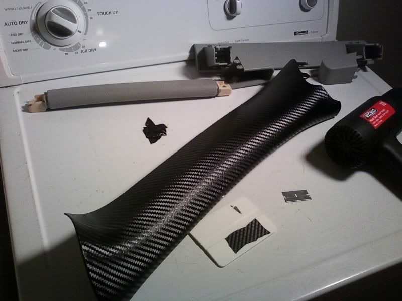

1st things 1st. Make sure and get yourself a nice heat gun. You can use a blow dryer but you won't really get the result you need. 2nd, you'll need an exacto knife or some razor blades. 3rd, get a plastic squeegee, like the one's they use in the vid's, and some paper towels. I always use glass cleaner to clean off the surfaces, but what ever you want to use to clean the surface would be fine. Once you clean the surface, get some masking tape and tape it to random area's on the surface. If it sticks, you're good to go, if not, clean it again.

now, if you want the texture of whatever it is your wrapping to come out then you can do what i call texturizing. after the item is finished run the heat gun over the surface for about 30 seconds. The texture will start to show but if you want it to show more, then carefully pat the surface. Be careful, it's gonna be REALLY hot, so try to do it as the best you can. if you do then you'll end up with a result like this, if you can tell from the pic.
see how it looks like if there's wrinkles, that's the texture.
Another thing like to do is what i call "burning the edges". once everything is set in place and doesn't look like it's gonna retract, then i run the heat gun over the edges and press down on them. I found that it will help the vinyl NOT retract.
One thing i found that helps with wrapping something is to wrap the entire face of the surface, smooth that out first and then work on the edges. It will definitely help. I'll try to take some pix and post'em.

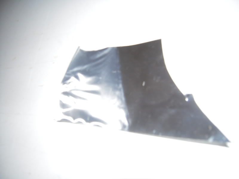

When ordering vinyl, PLEASE, PLEASE, PLEASE order sample's first. I promise you wont regret it. i've made so many mistakes with metallic based vinyl that i don't want anyone to go through. for example, i had plans of wrapping my side mirrors in chrome vinyl, then i found out that it wasn't meant to be stretched or heated. once you heat it, it loses it's glossiness and becomes matte. Here's two examples of what i mean. the first one is chrome vinyl and the 2nd is fine brushed aluminum.
left side is heated, right side is not
the corner is heated and the rest isn't

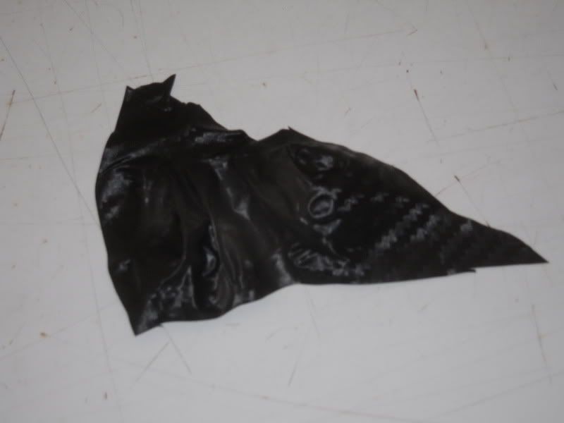

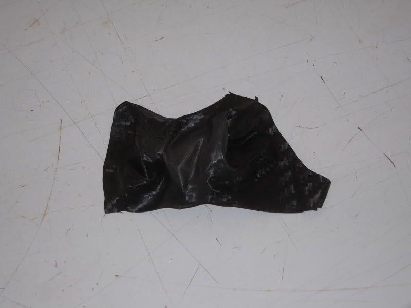

Also, because vinyl retracts don't ever think you've wasted a whole sheet. if it's crumpled up, just try to unfold it as best as you can and then shoot it with the heat gun, trust me, it'l go back to it's original form. might not be to perfect but at least you wont have to cut another piece. like this
CRUMPLED
UNFOLDED
RETRACTED

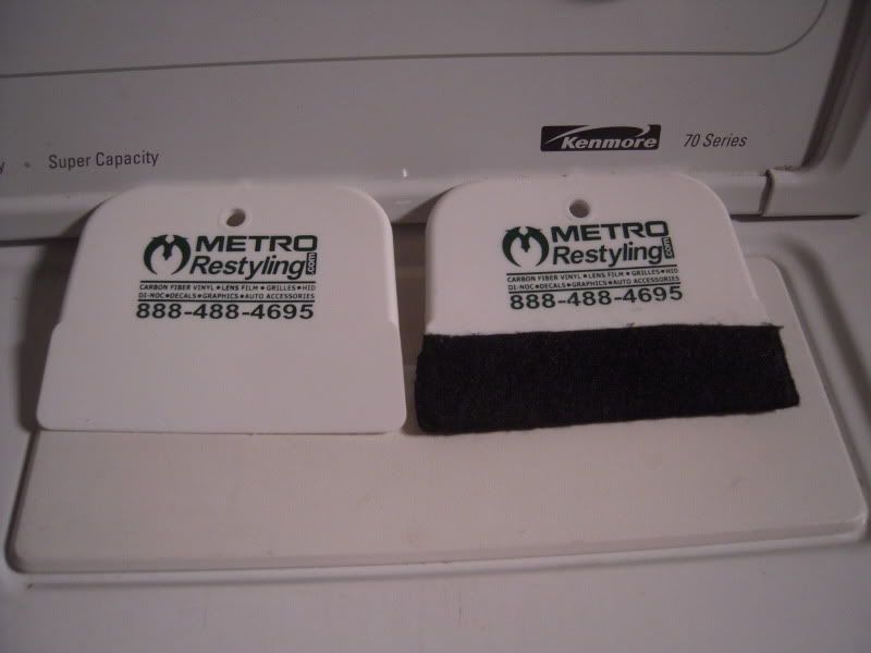

One thing about the sqeegee's is that some of them are sold with felt at on of the ends. I say screw that, i can buy two for the price of one of tho's, or i could just make one, which i did. I took one of my free squeegee's i got from metro and a piece of felt i ordered as a sample swatch from ebay and made my own.
got the felt and sprayed it down with some very strong spray glue and glued the felt to the end of the squeegee. then i just cut off the extra felt that was hanging past the sides and there it is. only cost me a $1 for the felt swatch.
